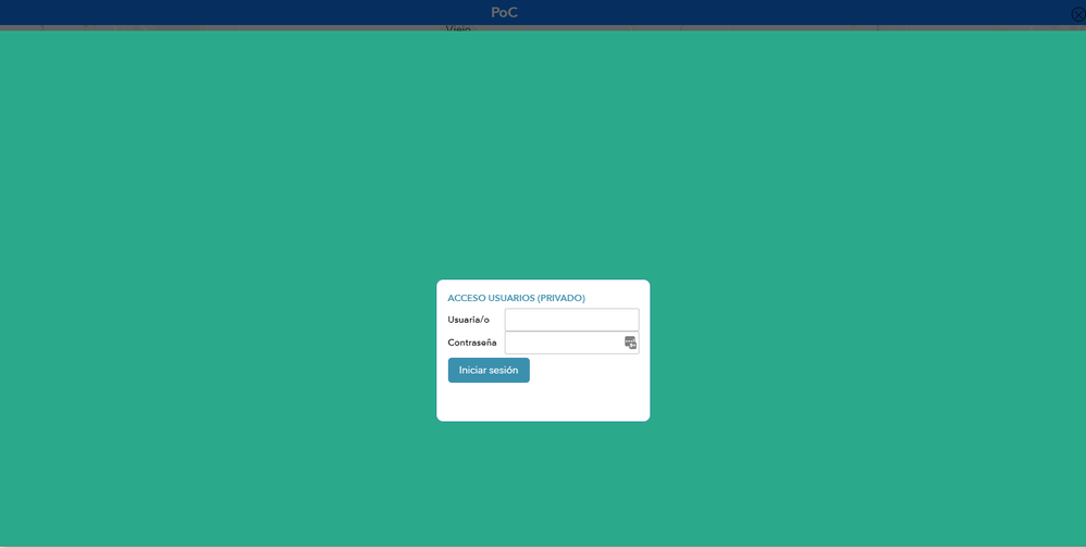

Hi,
I've developed a Experience Builder Widget, that has a "Iniciar sesión" button. I've added this Widget in a fixed window (splash screen) and when I click in the "Iniciar sesión"  button, I want to close the window.
 Regards,

LuisAntonioRodriguezGonzalez
Thanks, but this solution is not suitable for me, because I,ve developed a custom buttom in my custom widget.
The custom buttom has to do some actions before close the splash screen.
This is my code based on the KevinHibma answer:
export default function Widget(props: AllWidgetProps<IMConfig> & ExtraProps) {
  let linkCloseRef: HTMLButtonElement;
  const getLinkComponent = () => {
    let linkTo: LinkTo;
    linkTo = {
        linkType: LinkType.Page,
        value: "current_page"
    } as LinkResult;
    let queryObject = props.queryObject;
    return (
      <Link ref={ref => (linkCloseRef = ref)} to={linkTo} target="_self" queryObject={queryObject}
        className="linkClose"
      </Link>
  const onIniciarSesion = e => {
    const usuario = getUsuario();
    const password = getPassword();
    if (usuario === null || usuario === '' || password === null || password === '') {
      setMensajes(`${getI18nMessage('introducirUsuarioPassword')}`);
    else {
      const url = `${props.config.wsl}/Login.ashx`;
      esriRequest(url, {
          query: {
            u: usuario,
            p: password
          responseType: "json"
      }).then(response => {
        let geoJson = response.data;
        if (response.data.cr === 1) {
          if (response.data.np === 1) {
          else {
          linkCloseRef.click();
        else {
          setMensajes(`${getI18nMessage('errorUsuarioPassword')}`);
      }).catch((error) => {
          console.error(error);
  const LinkComponent = getLinkComponent();
  return (
      <div className="jimu-widget-acceso-filtrado">
        {LinkComponent}
        <div className="overlay"></div>
        <div className="envelope buried">
        <div className="contenedor">
          <table className="acceso-filtrado-table" cellSpacing={5}>
          <tbody>
            <td colSpan={2}>
              <div className="acceso-filtrado-btn" onClick={onIniciarSesion}>
                <FormattedMessage id="iniciarSesion" defaultMessage={defaultI18nMessages.iniciarSesion}></FormattedMessage>
              </div>
            </td>
            </tr>
          </tbody>
          </table>
        </div>
        </div>
      </div>
