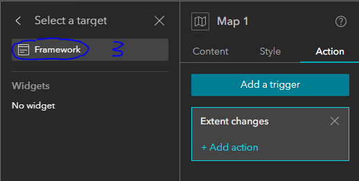

I'm creating my first experience builder app.  I have a list widget that zooms my map when I select a feature in the list.  However, I'd like to create an action on the map widget to filter the list when panning and zooming to show only features in the list that are visible in the map.
But when I attempt to create this action there are no widgets shown.  It's strange because the map widget shows when creating an action for the list.  But when creating an action for the map, I see no widgets listed.

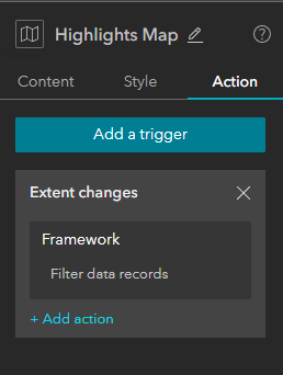

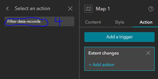

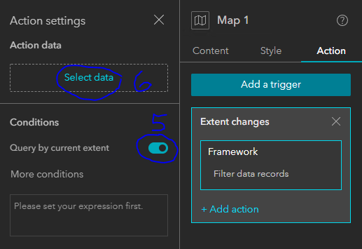

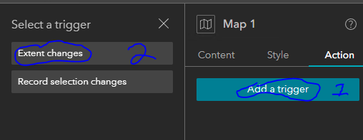

You can filter the data records within the Framework itself rather than a specific widget:
GarySchells
Thank you for the reply. I’m quite new using experience builder. Can you provide some direction on how to do that?
DaveFullerton
This will filter the data at the application level, so all widgets connected to this dataset will show data filtered by the map extent.  If you only want the data to be filtered in your List widget you will need to look into creating views within ExB.  You could create a view that shows all of the data (duplicating the data in appearance), then select that view for this trigger/action instead of 'Default':
