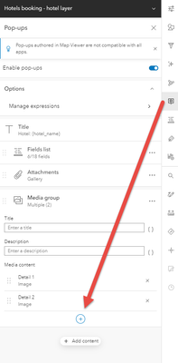

If you want to show the image in the popups, you can add it in the Map Viewer. Select the layer and choose Configure pop-ups, then Add Media Content:

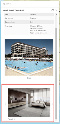

Then the image will be added in the pop-up:

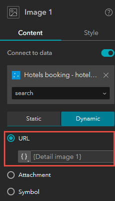

Another way is to use an image widget and connect it to data to use dynamic content.

Hi @GISREAL ,
