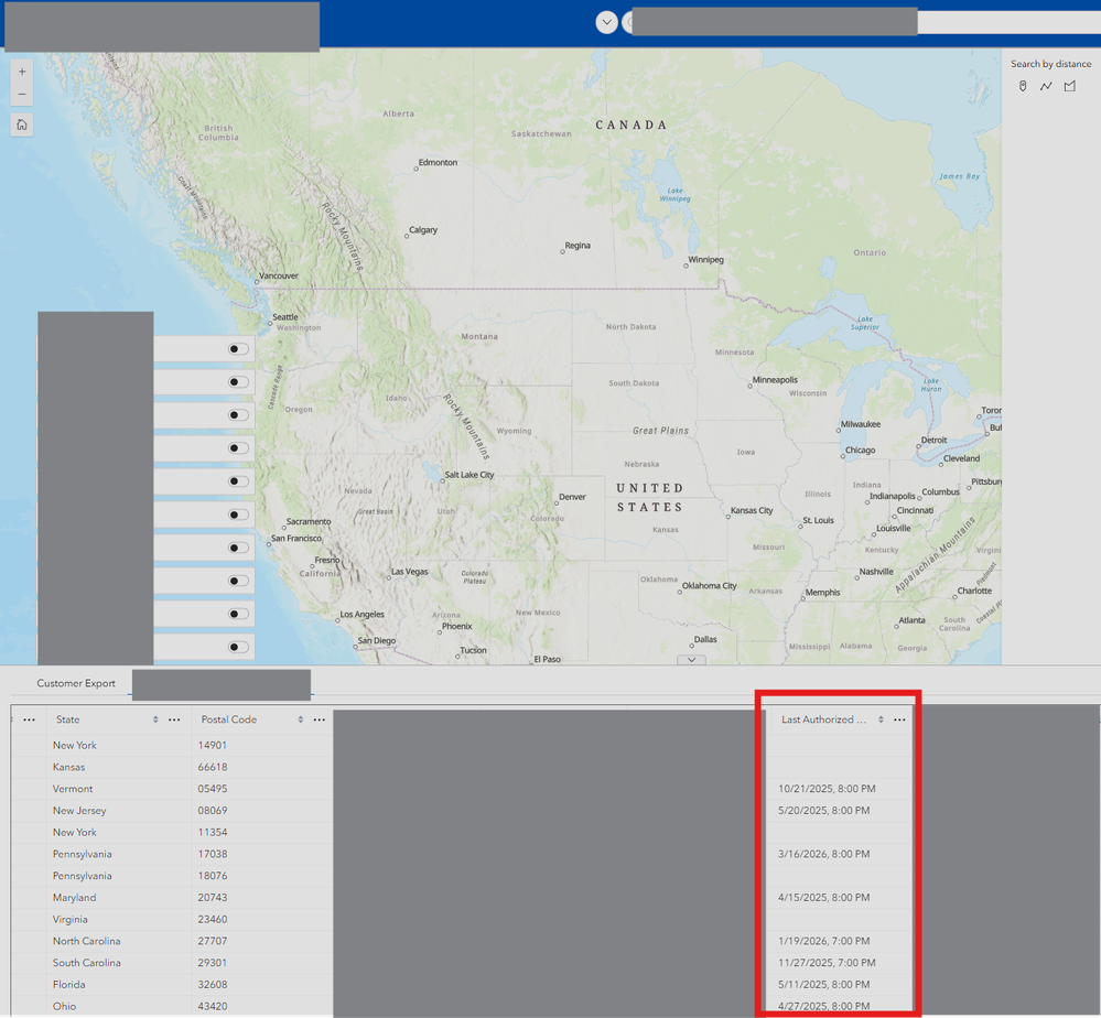

02-16-2022 09:47 AM
AmyRoust
I'm using the Table widget in Experience Builder (the online version, not developer edition). My date fields are displaying the time, and I'm wondering if there is a way to hide that? Time is irrelevant for this dataset - they just need to track the date.

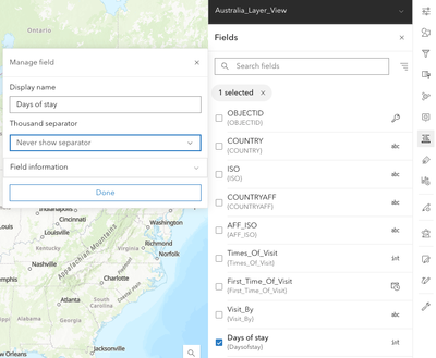

Shen_Zhang
@NicholeSalinger, the table widget now supports Map Viewer date and number formatting (effective October 2025 for ArcGIS Online). These settings persist automatically within the widget.
If you're using ArcGIS Enterprise, this feature will be included in 12.1.
Shen Zhang

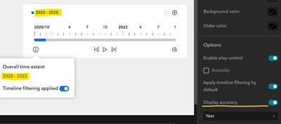

TonghuiMing
@BrittanyBurson
The new option "Display accuracy" added in the recent AGOL release can allow you to define the level of info you'd like to display now:
Tiff
Hello @TonghuiMing where do you find this setting? I do not have a slider, I just have a table I would like to remove the time from, and display just the date.
TonghuiMing
The Table setting needs to be handled by the Table widget, it uses the API widget so I believe there are some complications. The ENH I mentioned above is only for the Timeline widget.
