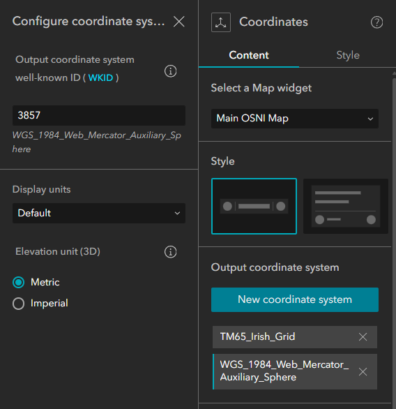

I have basemaps of different projections, but when I select a different basemap it won't show the coordinates.
The widget help says 'You can configure the widget with a variety of output coordinate systems and transformations.' I've added a second coordinate of the basemap I want them show but it just says 'Click the map to display coordinates' where it should show the coordinates.
Here is my set up below:

I would recommend reviewing the following Knowledge Article, as this may explain why you are running to this issue: https://support.esri.com/en-us/knowledge-base/problem-coordinates-not-displayed-in-the-arcgis-experi...
It is likely that the coordinates are not updating dynamically based on the cursor’s position because the coordinate system you have selected does not match the coordinate system of the map. Take a look at the article above for more details.

Yes, it seems that only one coordinate system is allowed, which is a pity.
