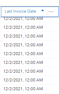

I'm using the Table widget in Experience Builder (the online version, not developer edition). My date fields are displaying the time, and I'm wondering if there is a way to hide that? Time is irrelevant for this dataset - they just need to track the date.

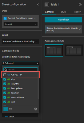

You can hide fields in the table widget settings.
Uncheck unnecessary fields to hide them at runtime.

@ShengdiZhang - that won't resolve my problem. I'm asking about hiding the time in a date/time field. I don't want to hide the entire field, but rather just the time. (See screenshot in original post.)

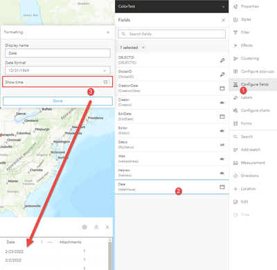

If you just want to hide the time but keep the date, you can open your map in the new Map Viewer.
Select the layer, click on "Configure fields", and then select the field Last Invoice Date. Disable the "Show time" option, and you can see that only a date remains in the field.
AmyRoust
Thank you, @ShengdiZhang . Unfortunately, the table widget in Experience Builder does not honor that setting. I already have the time suppressed in the Map Viewer, but it still displays in the table widget.
