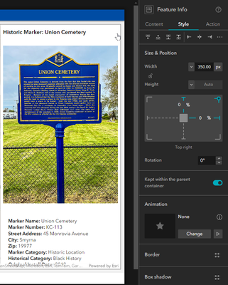

I've noticed this issue as well.  In the application I'm building, only one point will be selected at a time.  The popup information shows data details and a picture.  If the picture is large/long, the data details are pushed below the bottom of the page, without an option for scrolling.
I have the width of the Feature Info set to a specific value, but the height set to Auto, so that the window collapses when no point is selected, and expands when a point is selected.
Scrolling of the Feature Info widget when "Selected Features" is chosen would be a big help!
