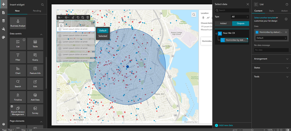

In the Near Me widget I have analysis settings pointed to my map, and properties(parcels) setup under the analysis layers along with address points. Then in the List widget, I have property data selected under outputs->Near Me -> Property Data.
Trying it out live, I run near me to get the parcels, but in List, nothing shows up. Not sure what I'm doing wrong, I just get the row of buttons with 'Property Data' listed.

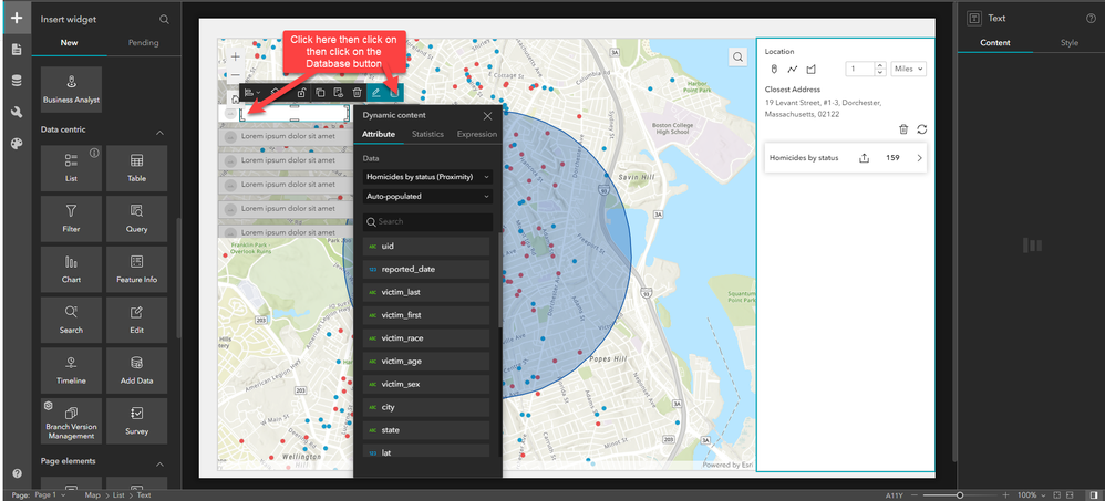

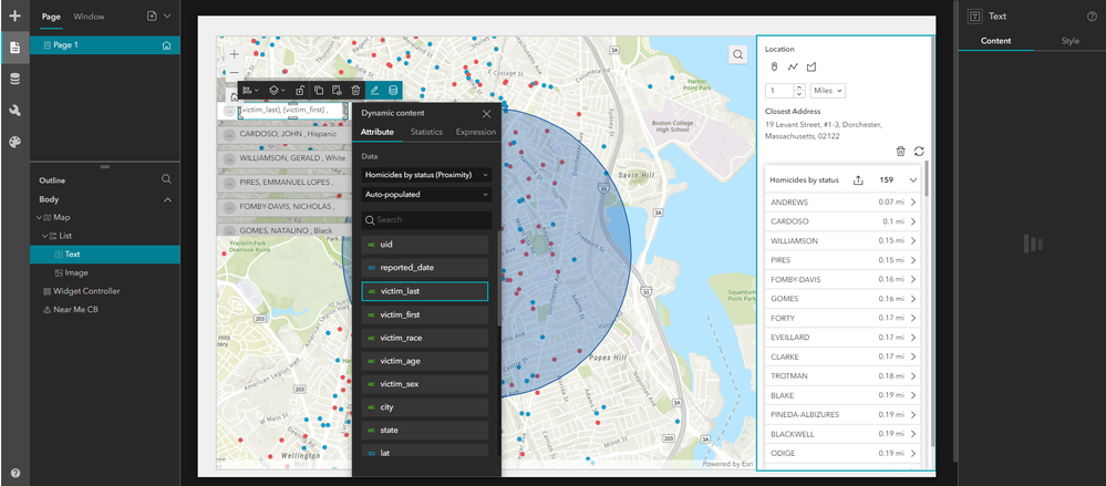

If you must use Experience Builder, then setting the output of Near Me in the List widget's data source should do this. After you set the output data from Near Me in List widget, did you set the field's in the list widget to show? If not here are the steps to do so:
1. In the List widget content,  Make sure Near Me output data is selected
2. Then click inside the list widget and click on the database button to set up the dynamic content, here you should see the list of output fields from Near Me.
3. Then add fields to List widget from this output field list. It should show up when you run Near Me analysis
Please let me know if you still have problem showing Near Me output in List widget.
