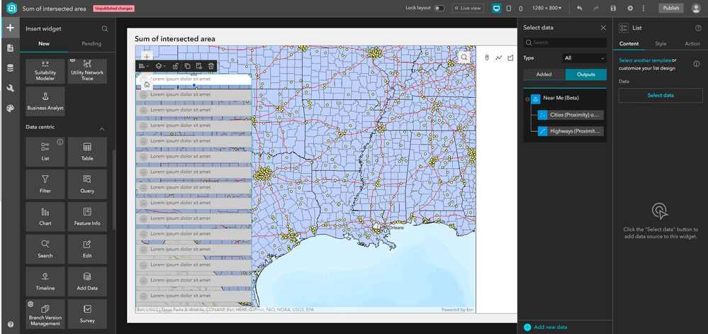

Hi @JillWeber ,
We added support for Near Me to create output data sources that can be used as input in other widgets, like List, Table or Feature Info. So you can accomplish your above mentioned workflow now. First configure the analyses in Near Me, then add List widget, Click on Select data, from the Select data panel, click Outputs and you should be able to see Near Me output data sources.
