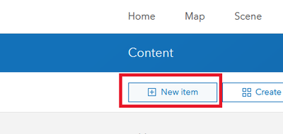

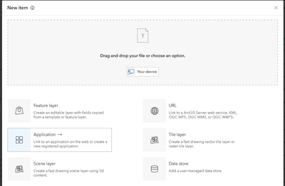

You'd be looking for App ID rather than Client ID. I am on 11.0 right now, but I cant see this method stopping in the next version.
Just need make an App for use with EB-D:
Go to your Enterprise Portal > Content > New Item
 Application
Select Other Application
Then edit the Redirect URI's with your machine info.
This App can be used with EB-D.
 Application

I think using the AppID did the trick!  Thank you for your help!  Much appreciated.
