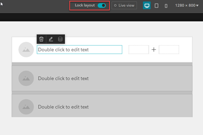

I think it's because you have the Lock layout option enabled, can you check that?
Regards,
Shengdi
KaraUtter
It is not because of the lock. I was editing in unlock mode but the screenshot was taken when the layout was locked.

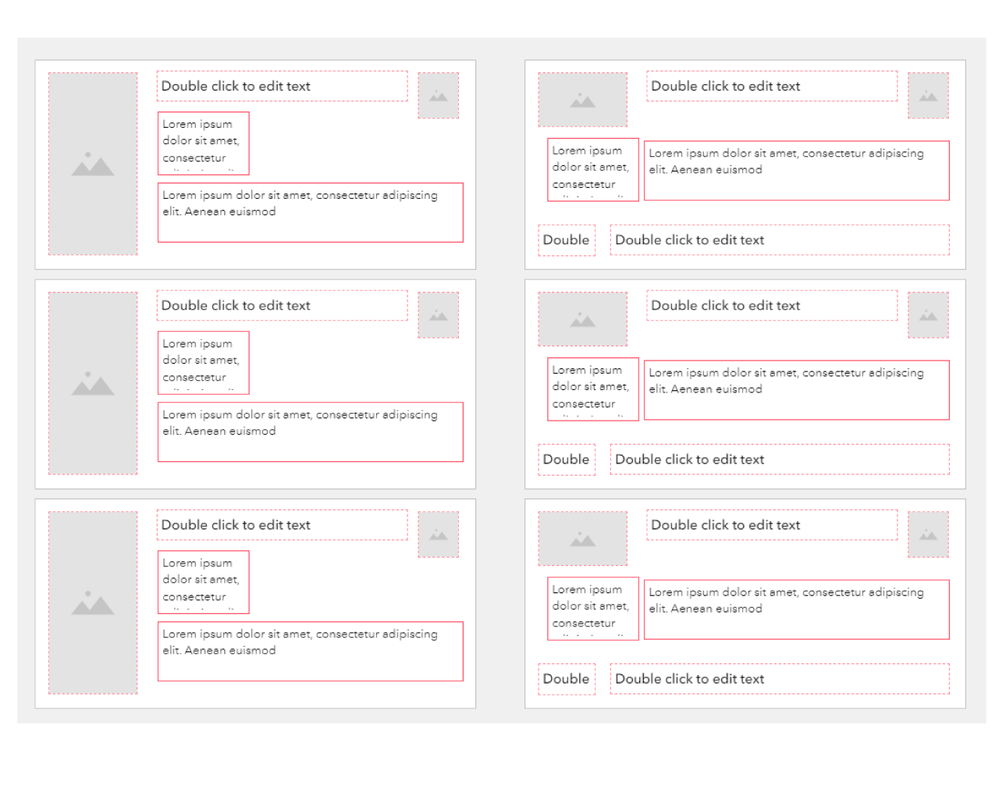

Are you using the EB developers edition? I just finish an app using the list widget and I was able to resize all elements within the list widget container. The only issue is that the size is not dynamic, meaning that the size of the parent container won't resize or react to changes in size of the child container. EB_List-widget.pngEB_List-widget.png
