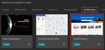

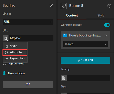

If you want to link the button widget to a different page, you can use the URL address as a field in the data source and use that field in the button link.
However, for your case, there is a simple way. The online template Hotel booking is a good example, and you can create one yourself. In this sample template, a window with item details can be opened via the list button (on the search result page).
Open the window Details, select the text widget, and see the selected features view is selected.
Therefore, when another feature is selected on the list widget, the content of the text widget using the selected feature view also changes.

thank you. I did not see the choice "Selected Features" until you showed me. Still learning! I appreciate it.
