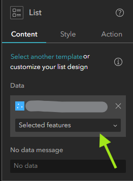

Hi SallyBickel,
You can select the Selected features in the list's data view settings. This way, when no feature is selected on the map, the list will show no data records, and only selected features will appear.  Hope this helps.

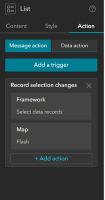

In addition to  ZhenZhang22 suggestions
I believe you can modify the list by click selected (rather than default) and then
Configure this.  You may need to add an action to update the selection when you do this, but I think you can select an individual item from the list this way
Updating Media
Let us know if adding these settings/actions helps also.
