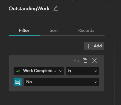

I created a view for this clause.

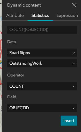

I added a text widget and connected it to the data.
Set up the expression:
This works and shows the correct count when the app loads.

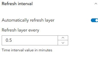

I have also set the refresh interval on the layer in the map to 30 seconds:
Yet this number does not change.

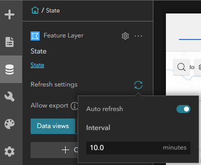

What happens if you try modifying the refresh settings within Experience Builder? (I have no idea what this will do if the refresh interval on the actual service is higher/more time, so maybe both have to be 0.5 minutes?)

That was it.  I was not aware the app had a refresh interval too.
