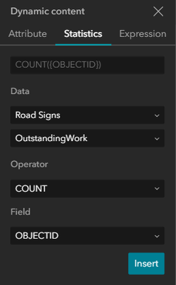

Select the text widget and click the Dynamic content button (stacked circles above the text widget)
In the Dynamic content widow select the Statistics tab.
Under Data it should list your feature layer and below that the view you just created.
Change Operator to Count.
Select OBJECTID as the field:
 Click Insert.
The text box should now show the count:

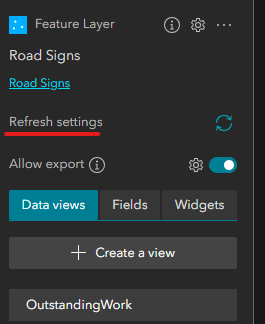

The last step is to turn on the refresh interval.

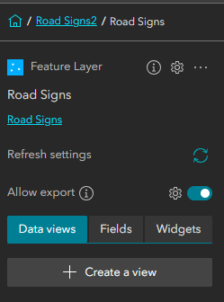

Click the Data button again from the left side.
Select the web map and then the layer.
Below the Feature Layers link you should see "Refresh settings":
Click the circle arrows to the right of Refresh settings.
Toggle on "Auto refresh" and change to Custom.
Update in minutes how often you want the data to refresh:
