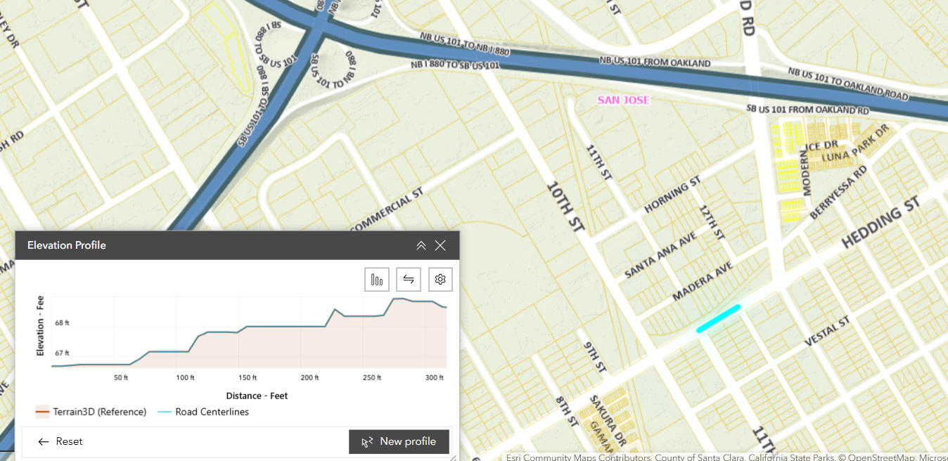

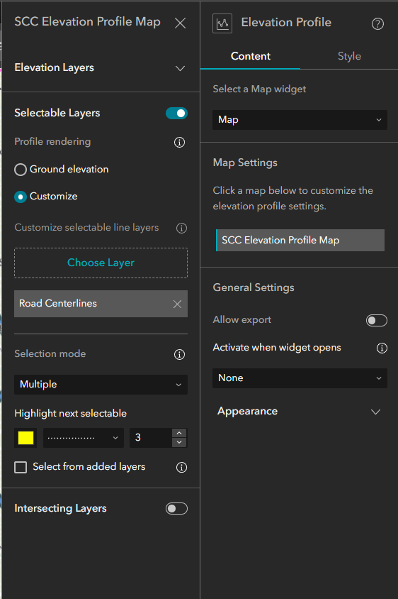

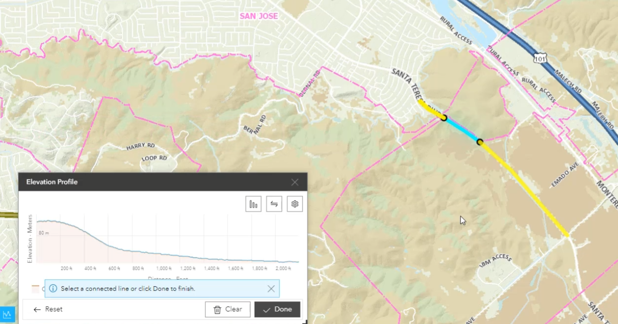

The Elevation Profile Widget in my ArcGIS Online Experience Builder App is configured to select one line layer with Multiple selection mode:
It worked as expected for a long time.
But it stopped working several months ago and now behaves like Single selection mode
I am wondering if it's related to recent ArcGIS Online update. Has anyone else seen this issue in ArcGIS Online?
