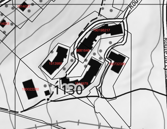

Hello,
I am using Experience Builder 1.5 Developer Edition to create a Web App.

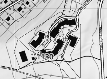

The strange thing is, that in my application the labels of layers are not showing. If I look at the webmap everything is ok, but in the actual application the labels are just not there.
Any idea what could cause that?
Webmap                                                                      Application

ExB does not handle the web map rendering. It is up to the Map widget in JSAPI. There might be an issue in that version of JSAPI. As a try, could you create a similar map in the online map viewer, then bring it to ExB online version and see if the problem occurs. If not, I would recommend upgrading to dev edition 1.6 available on October 20.

In any case, I think this might be a bug in Experience Builder 1.5 Developer Edition. I just tried with the older version 1.3, which I still have installed and there the problem does not seem to exist. Everything works as it should.
Martin1
Thank you for your answer. Indeed in ArcGIS Online it seems to work as it should. It could really be a bug in the JSAPI, as I see the same behaviour in Web Appbuilder in Enterprise. I will stick with ExB 1.3. for now and try 1.6 once it is out.
