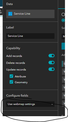

Ah yes, the Edit widget in ExB must use the web map settings for field configuration. Nice work pinning it down!

Configure your form in map viewer and choose webmap settings in the editor widget.
The tables themselves won't be added to the editor widget. They will be added in with the layer they are related to. So those 2 will be under the same editor panel.
