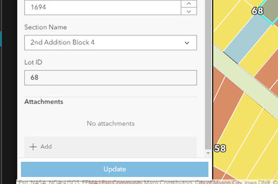

Would it show up down here under some related tables heading? I even deleted and reconnected my map to the app.
AlixVezina

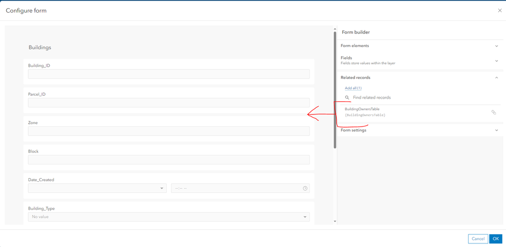

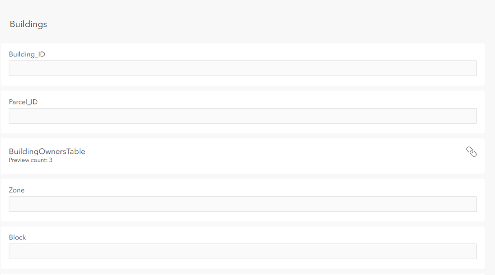

From the web map in Map Viewer, when you build the Form for your parent layer, make sure to add the related records to the Form.
AlixVezina_0-1700063405157.pngAlixVezina_0-1700063405157.pngAlixVezina_1-1700063420999.pngAlixVezina_1-1700063420999.png

I did! Turns out I had customize as my option for editing in EXB but you have to choose web map setting instead.
