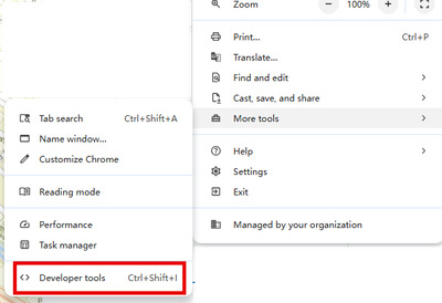

Hi, are there any errors in the Console? You can find the Console in Chrome settings - Developer Tools:
If you add the utility via URL, does it work?

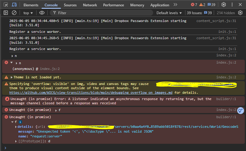

I am getting an unexpected token request error? The URL for the locator is set to reference back to my portal for some reason? see attached.

We did have some known bugs related to utility login in 11.3, but this issue doesn’t appear to match any of them. Since I can't reproduce the bug on my side, I recommend reaching out to our Support team to help reproduce it.
In the meantime, could you try opening the locator URL directly to see if any warnings appear? Also, if you add the locator by URL (not choose from the Organization utility), does it work as expected?
