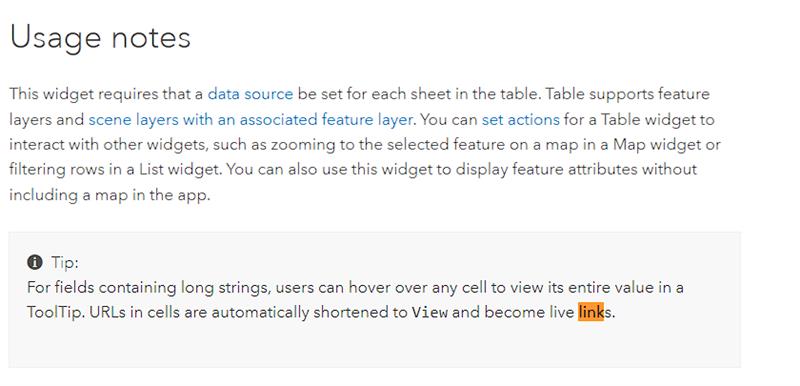

Hey everyone, coming in here to ask how it would be possible to enable hyperlinks in the Experience Builder table widget. The links are working fine in my configued popup, but I would like users to be able to click on the link in the table widget to save time. The screenshot makes it clear that URLs in cells are supposed to automatically shorten and become live links, however it's not working in the widget. The link is http, could that be the reason? I'm open to any suggestions.

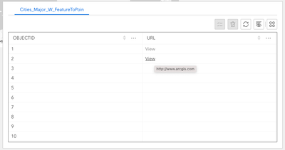

Hi @ZacharyForsythe
Links within the table have been simplified and replaced with a "View" hyperlink. Clicking on this will direct you to the associated URL in a new browser window.
Both HTTP and HTTPS URLs are compatible within table. If you're experiencing issues, we would appreciate additional details to replicate the problem and address it more effectively. Thanks!

Shen_Zhang
Hi @ZacharyForsythe
