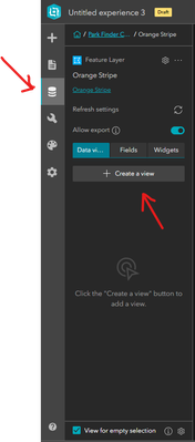

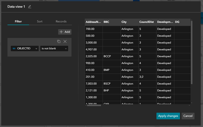

This is what Data Views are for. Data Views are independent slices of your total dataset. You should set up a Data View for each page of your application.
Click the stacked circles on the left of the screen to open the Data Sidebar. Then click on your data and go to Create A View.
Create a SQL query with all of your data. OBJECTID is not blank will work. You'll probably want to give each View a distinct name to match what page they are used on. You can click the pencil in the header to rename. Repeat and make a Data View for each page.
When selecting data for a widget use the dropdown menu to find the correct Data View. (You can also set up your Data Views from this menu.)
Each page should now act independently.
