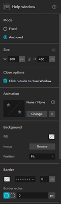

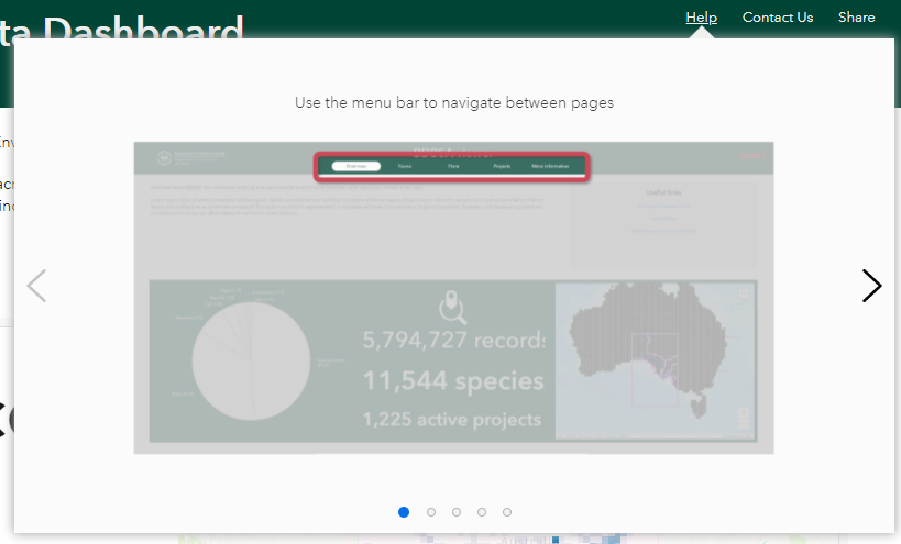

I have an experience builder page (ArcGIS Online) with text in the header which links to an anchored window with help information (screen shot below).  When I click on the link, the window appears but then disappears again after 3 seconds (consistently 3 seconds).  The same is happening for the other two links (Contact Us and Share)

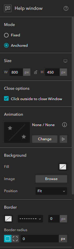

I have the setting to 'Click outside window to close' checked.  Screen shot of window settings below.
Am I missing a setting?  How do I ensure the window stays open until the user clicks outside the window to close it?
I believe this is relatively new behaviour.  It's not something I've noticed before, and I distinctly remember previously having to click out of the window to close it.  It is happening both in the editor, and when viewing the published version of the experience builder.

We can confirm that this is a regression bug of the text hyperlinks and we plan to fix this bug in the next few days.
Until this bug is fixed, you can use button widgets (make sure the background and border are correctly set for both Regular and Hover) instead of these text widgets to link to anchored windows.
