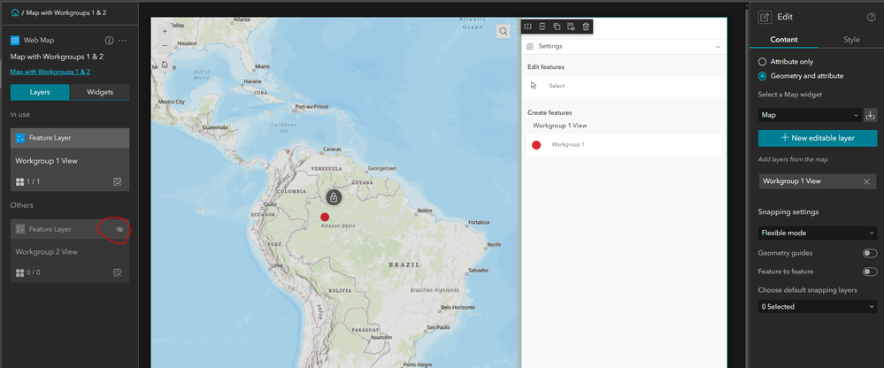

I created a very basic sample to illustrate how this could work:
Notes:
  • When you create the Views for each layers belonging tor each of your workgroups, filter the data based on your workgroup domain values, and hide any fields not associated to the current workgroup for the view.
  • Make sure to enable editing on your Hosted feature layer views; they are not editable by default when you create them.
  • You’ll want to author the editing Feature templates for your View layers. Right now, the easiest way to achieve this for will be using the Field Maps Designer application. (Not intuitive, I know – this functionality will be available in Map Viewer soon)
  • In Experience Builder, when you add a web map as a data source, you can choose which layers from the map are available.
    I hope this helps!
    Let me know if you have any further questions regarding how this was setup.

Thank you for the information.  I can definitely see how that would work.
What I ended up doing was creating a "Workgroup" Feature layer and using it as basically a look up table to auto-populate the Workgroup field with an arcade expression.
In the data definitions of the Exb for WG1  I filter all layers by "Workgroup 1" and in the Exb for WG2  I filter all layers by "Workgroup 2".  Both ExB's use the Master Feature layers.
I like your solution and when I get a chance, I will definitely Test it out.
Thanks for the help.
