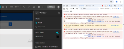

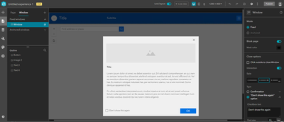

This is what I get in console. I am on a dev machine without access to the internet and I am not concerned about the cert error which  I suspect is because it is self signed.
The network requests are as shown above and there are  no failed requests. I can see requests to locally hosted API and requests to local ArcGIS Enterprise. The last request on the Network tab is the last request I see and nothing happens after that. The IU looks like this and becomes unresponsive
BolanChen
I think your problem is because the lock layout is turned on. You can try turning it off.
wadsonmakari
@BolanChen I have switch off  the lock layout but it is still not going any further.
