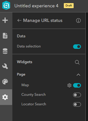

Yes, remove the <> characters. You will also need to enable the URL Parameters from the settings within Experience Builder.

I've set the URL parameters for Map to on, and I've looked at the 'Define Map Viewpoint section' but I'm afraid I don't understand what it all means and how to get from the JSON format to the URL. I guess if I could get one example to work, I could tweak for others, but I'm not getting anywhere. No matter what I enter, I just get a full screen.
