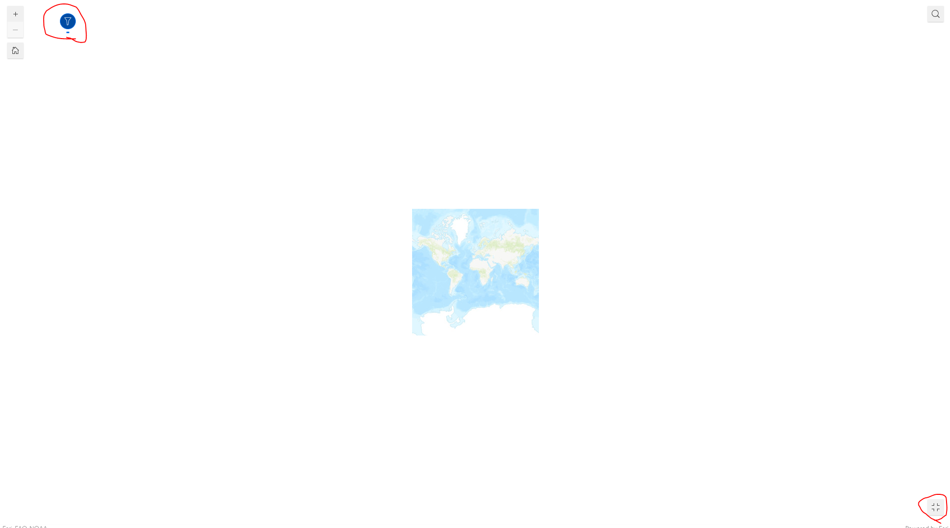

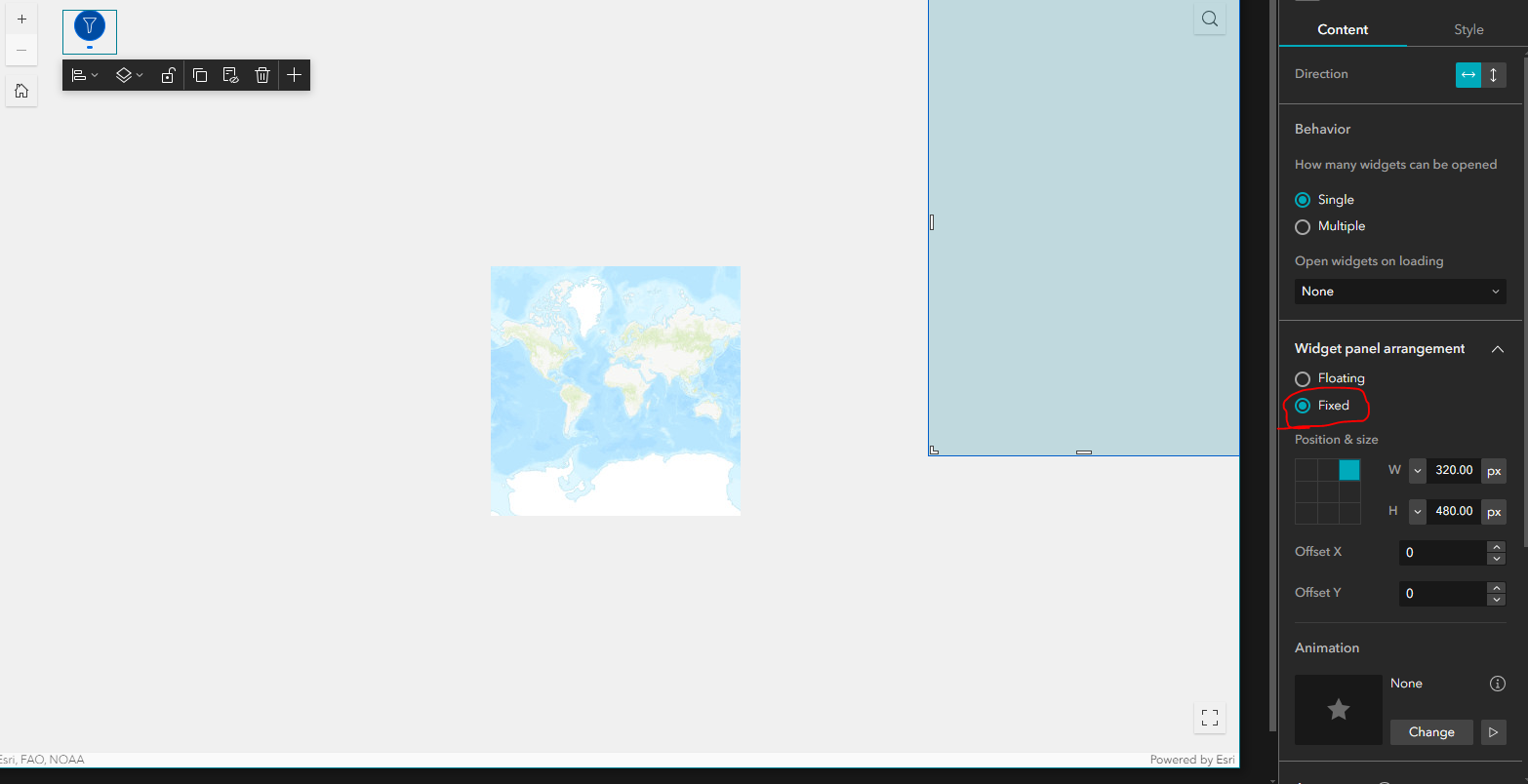

In ArcGIS Experience Builder Developer Edition (v.1.15), I am unable to open a widget in a widget controller when I attempt to open the widget in Full Screen Mode. I have the widget panel arrangement in the widget controller set to 'Fixed'. When I have the widget panel arrangement in the widget controller set to 'Floating', I am able to open the widget in full screen mode.
Reproduction steps.
1. I create a widget controller and add a widget in there and set the 'Widget Panel Arrangement' to 'Fixed'
2. I click the full screen button and attempt to open the widget in full screen and a panel does not appear, when it is expected to appear at a fixed position on the top right.
Any help on this would be greatly appreciated. Thank you!
