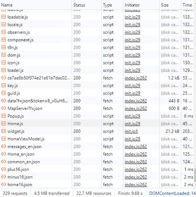

My Experience Builder gets stuck after I choose the Foldable layout and click the Create button. The UI becomes unresponsive at this point and nothing happens. Inspecting the Network traffic in the Chrome Developer tools shows the calls below. I can see EXB accessing resources from my locally hosted API and making calls to local Enterprise Portal as well.
Does anyone know what calls EXB makes after the last request shown below? I trying to get what calls EXB makes after the last listed call so I can get a clue what could be wrong with my setup?
Any clues as to what I could check next will be much appreciated.
The console shows a cert error that I am not concerned about as it is a dev machine and I am in a closed environment.

@wadsonmakari If you create an app through other templates, can you enter the builder normally?
wadsonmakari
@BolanChen I am getting the same behaviour regardless of which template I choose to builder the experience on. Does anyone know what is supposed to happen next? If someone can tell me what is meant to happen next perhaps that can give me a clue as to what may be wrong with my setup.
BolanChen
From the existing information, we cannot determine where the problem is. Can you provide more detailed network request information and error messages in the console? We need to confirm whether there is a problem with request request error or code error. This will help us locate this problem.
