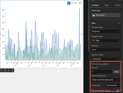

Hi @Wei_Ying  , I have tried this in Experience Builder, my date field is supported as a category field, but on the date axis,  the same date appears multiple times and there are no dates on the axis where there I have no data for that date (please see attached image; the axis skips April) .
I need the date axis to be a continuous set of dates without duplicates or gaps, like in Dashboard charts when you select the 'Parse dates' option. Is there a way to do this?
Wei_Ying
Hi @kawakawa4 ,
Thanks for your feedback!
Can you share how you set the time intervals?
If you are seeing multiple same date, it might because you are using interval that smaller than a day, say hour, minute. Also, if you didn't see date that have no data, you may check the option "Empty bins" that how you treat bins with no data.
Would you mind share your settings together with a view of your data attribute, so we can take a look.
Thanks,
Wei
kawakawa4
Hi @Wei_Ying  , thanks for your reply. I was trying the 'Empty Bins' options but they weren't working, until I changed 'Statistics' from No aggregation to Sum.  Working well now. thank you.

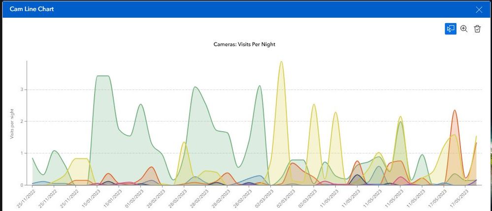

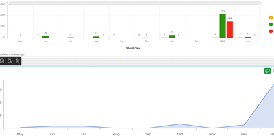

Hi, I know this post is slightly old now and your reply is over a year ago but just wondered if there is any view to adding the ability to parse dates within the bar graph and allowing for splits at all? This is all possible in the Dashboard App (which i'm trying to  migrate onto EB). I have graphs which show a total number per month which is then split into status', i'm only able to accomodate total count for the layer when using the line graph. Examples attached below. I believe the splitting of charts will be possible with the AGO update this week but still won't then be able to split via month like the line graph below...thanks!
