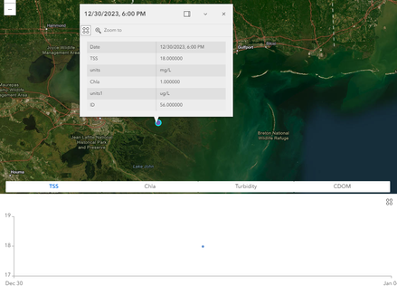

My attribute table looks like this:
I have yearly TSS (which is the parameter I am trying to display) data for each point (my table has 27,375 features, but I am working on displaying just the last 15 days for each point).
I am able to display all of them together:
But when selecting a station in the map, it is only displaying the last data:
Thank you very much for your help!

@CassiaBroccaCaballero Thanks for sharing the details.
Based on my understanding, each point has only one TSS value and one Date value. So when selecting one point on map it only show on chart, it is as expected (Map shows just one feature selection). As my understanding, the point location represents one station, but there are multiple record of one station showing different TSS values in different date. I think you should set up Message action from Map widget to filter data with the station identification. Thanks!
