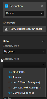

When I add a chart and connect to the data I can only select text fields as a category at the moment:

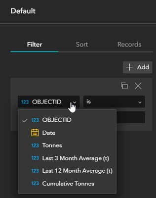

When I look to filter the data I can definitely see the date field:

Wei_Ying
Hello,
In the current released version, unfortunately chart does not support date field.
However, in the coming June ArcGIS online release, it will be supported.
To be noted, in bar/column chart, you can select the date as category field, but it will be treated as string, no further time setting. But line/area chart which is good for showing trending, will further support time binning setting, such as specific time interval setting.
Thanks
