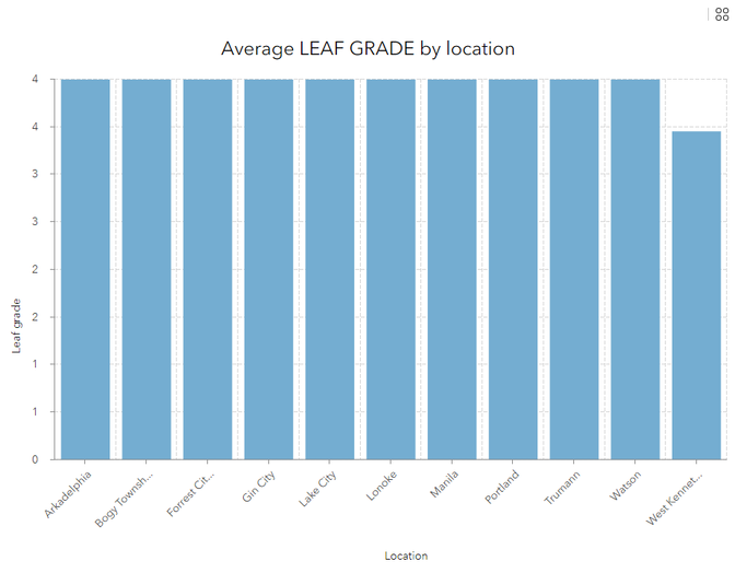

Another issue I am having is with the y-axis labels, particularly when the data is filtered to a smaller subset. There are repeated labels which looks pretty funky (0,1,1,2,2,3,3,4,4 in the graph below). Anyone else have this issue or know how to resolve?
Wei_Ying
Hi @LinzMess
Thanks for sharing the feedback. We have logged issue to fix the labeling problem.
Jennifer_Parmeley
I was able to work around the funky y axis by adding digits to that display. Adding the .5 for example.
