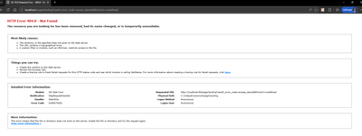

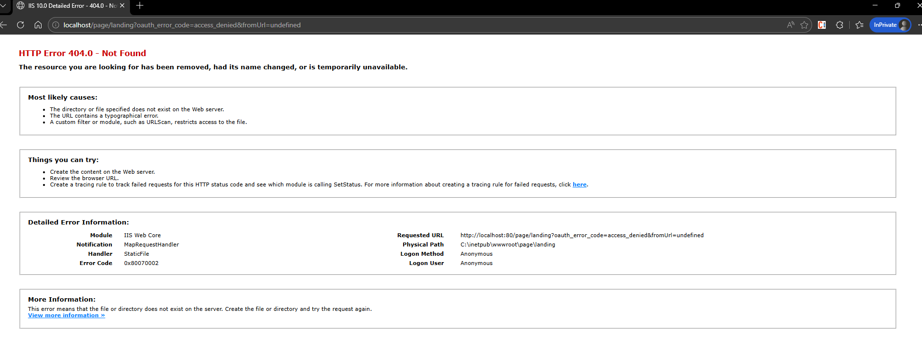

1. If the user click cancel login after click sign in from login widget in the landing page, the application will return to non-existence URL (see the URL address)
/page/landing?oauth_error_code=access_denied&fromUrl=undefined
Given that the landing page is home page, it should go to ?page=page_2 or just / ?

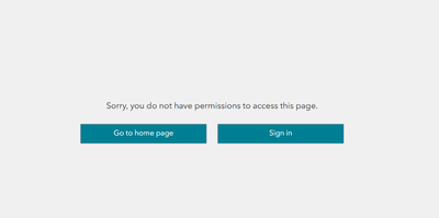

2. For page restriction out of the box message, the Go to home page points to /experience?id=undefined upon click
/experience should be only for builder preview right?
