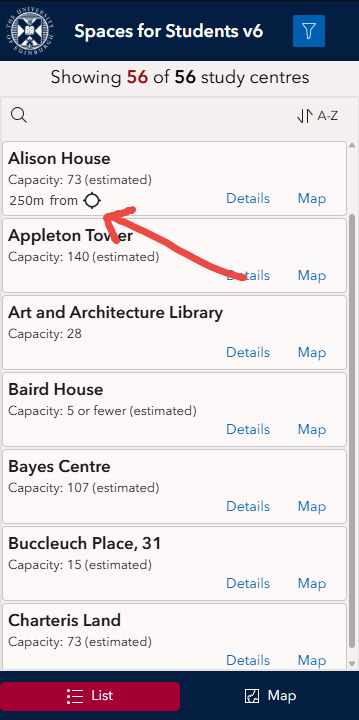

I think I know the answer to this, but I'm going to ask anyway!  I have an Experience that allows students to filter study centre (points) based on their facilities.  I'm displaying the list of buildings using the List widget.  What I'd like to add to each list item is the (straight line) distance from the users current location to each study centre as shown in the first record (Alison House) on the image below:
If this is possible, what I'd also like to be able to do is sort the list by distance from the users current location.

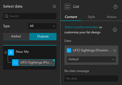

  1. Set up a Hidden Near Me Widget.
  2. While setting up your Near Me Analysis, make sure you have Include Approximate Distance turned on.
  3. In your List Widget, while selecting your data, go to the Outputs Tab and use the Near Me Output.JeffreyThompson2_0-1763055032114.png

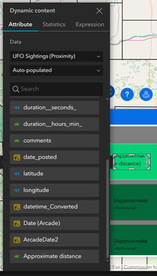

  4. Inside the List Widget, add a Text Widget and go to Dynamic Content. Approximate Distance should be an available Attribute.JeffreyThompson2_1-1763055143515.png
It should also be possible to use this Attribute as a Sort field.
