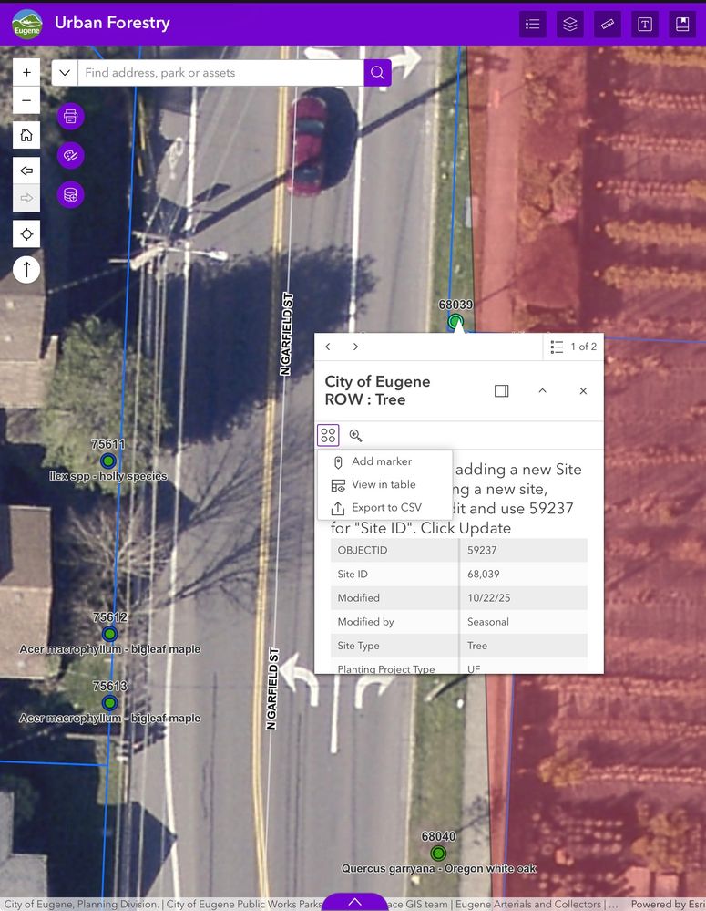

When I open any of the Experiences with editable data from a mobile device, the edit widget disappears and the option to edit in the actions button does not appear. I'm signed in as an administrator, so it shouldn't have anything to do with the user type or role. If you know of a setting that I'm not aware of that would allow mobile editing in an Experience that would be super helpful. My technical field leads edit from mobile devices in Web AppBuilder applications.
ToddJohnson

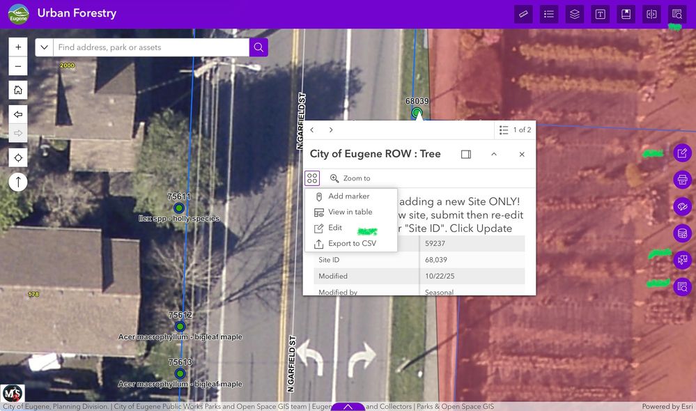

Update: I found that many of the data widgets (edit, select, query) all disappear when viewing from a cell phone. They also disappear when viewing from an iPad when held in portrait mode. If I flip the iPad sideways to landscape mode, all of those widgets and functionality returns, both in the widget controller and actions button from the popups!! With a little training for field staff...PROBLEM SOLVED!!!

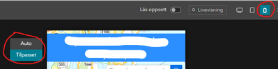

I had the same problems as @ToddJohnson but corrected this with switching between "Auto" and "customized" in mobile mode to customize it. This was the first page I landed on after googling the problem 🙂
