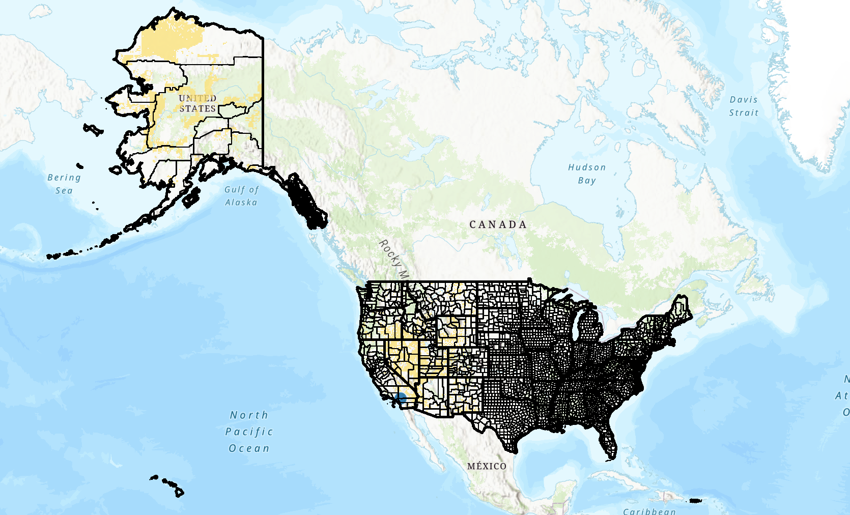

I am having screen size / resolution issues with Map Image Layers that are associated with my experience. When the computer screen is in the 1920 X 1080 resolution everything works perfectly, but when I switch to 2560 X 1440 the Map Image Layer is completely broken.
This image is the screen resolution at 1920 X 1080:
Screen Shot 2021-07-22 at 12.03.08 AM.pngScreen Shot 2021-07-22 at 12.03.08 AM.png
As you can see this is working perfectly.

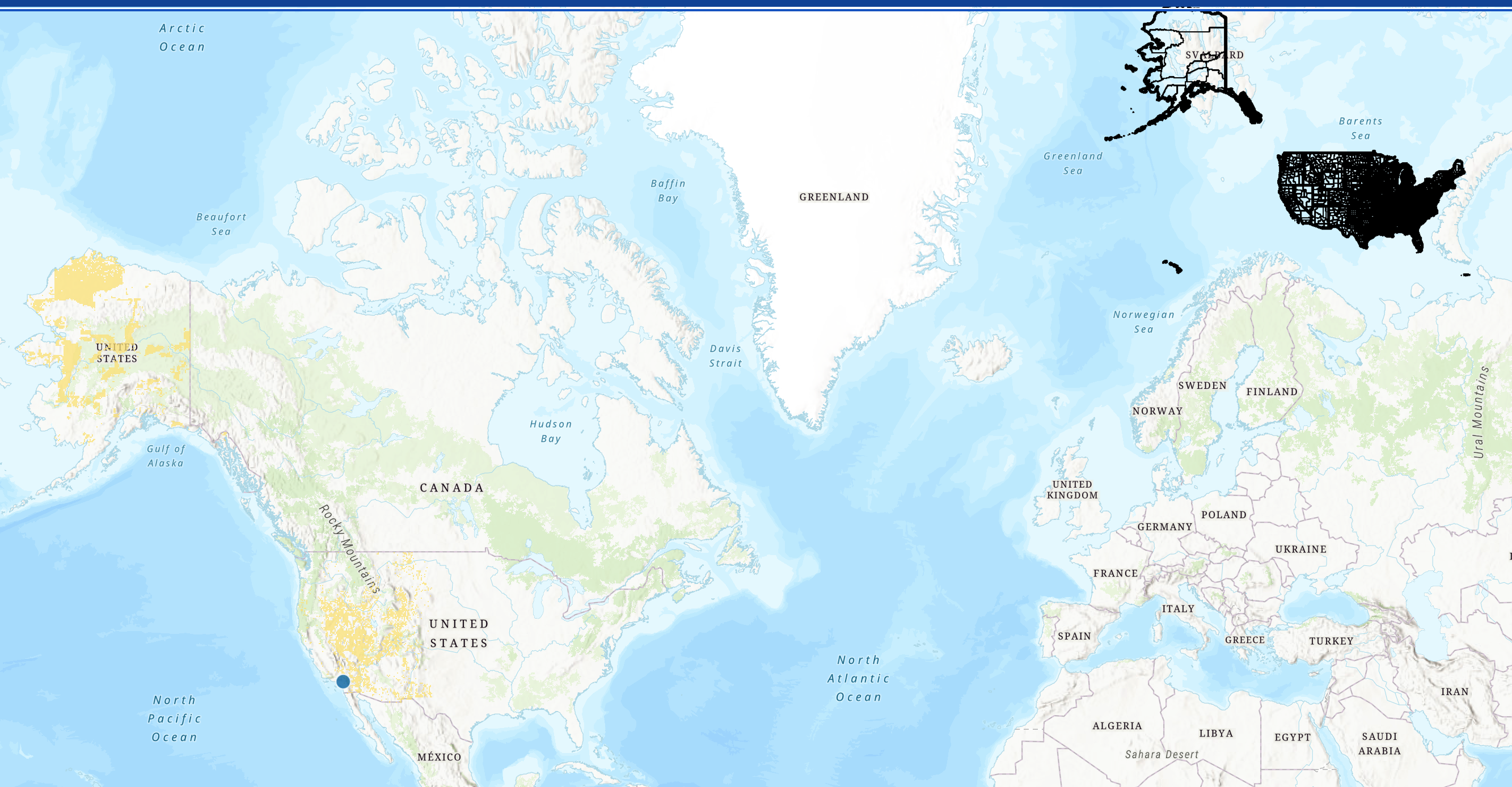

This image is the screen resolution at 2560 X 1440:
Screen Shot 2021-07-22 at 12.12.46 AM.pngScreen Shot 2021-07-22 at 12.12.46 AM.png
As you can see something is very wrong here.

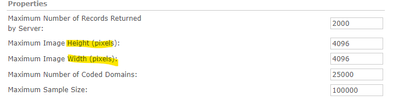

Hi,
Faced the same issue.
It can be fixed by increasing the Maximum Image Height and Width in pixels at the Map Service level:
The fact that it is shifted in the JS API is due to the fact that it asks for an image size that satisfies these limit s though it does not cover the full screen once generated.
Phenomena observed using ESRI Maps SDK for javascript 4.27.
