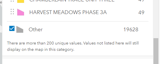

Can some assist me in adding or locating the print widget in experience builder? I am on a struggle bus. With that said, I am running into an issue with all my data symbolizing not symbolizing in my web map for my experience builder app. I have tried a few expressions that I have found, but I have no luck. Is there a limit on symbolizing? I am trying to symbolize the subdivisions.

There is a limit of 200 unique values with 10 unique colours to differentiate categories when creating a layer style in ArcGIS Online Map Viewer. However, you can create datasets with more than 200 unique values/10 unique colours in ArcGIS Pro or ArcMap and upload them to ArcGIS Online to circumvent this issue. This documentation provides additional details: https://support.esri.com/en-us/knowledge-base/faq-is-it-possible-to-display-a-layer-with-more-than-2...

Thank you for the response. I will take a look at the link you provided. However, I do not see the print widget in on the portal side.
