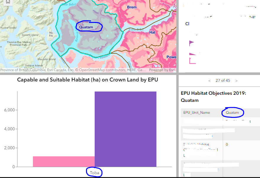

Goal: having the ability to filter a Chart either by selecting feature on Map or scrolling to feature in Feature Info widget
Issue: it does not seem to be possible to allow the user to filter chart both from the Map and from the Feature Info widget at this time
Alternative solution: allow scrolling between features to be disabled on Feature Info Widget

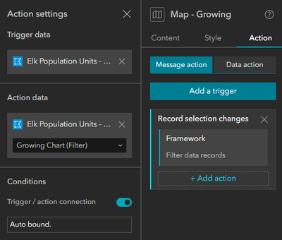

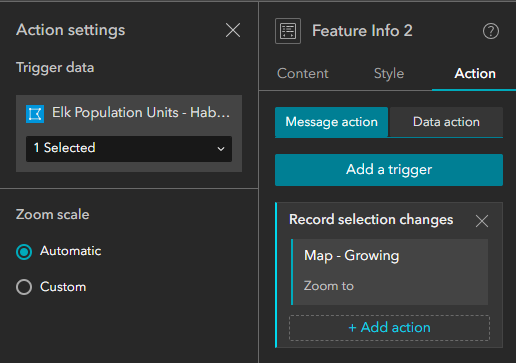

Configuration 1:
Map Action -
Feature Info - no Actions directly impacting Chart
Expected behaviour:
When record selection on map changes, either through clicking the map or scrolling through the Feature Info widget (which then selects record in map), Chart will be filtered
Actual behaviour:
Chart is filtered when feature is selected in map, but not when feature is 'selected' via scrolling through Feature Info widget

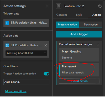

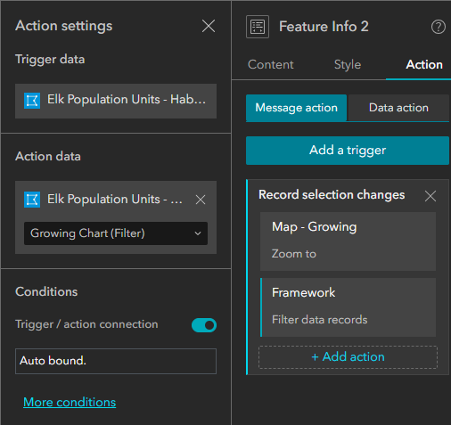

Configuration 2
Map Action - same as Configuration 1
Feature Info - Action set to filter Chart:
Expected Behaviour:
When record selection in Feature Info or Map changes Chart will be filtered
Actual Behaviour:
Chart is filtered when selected in Map, but gives INVALID CHART error when scrolling through Feature Info:

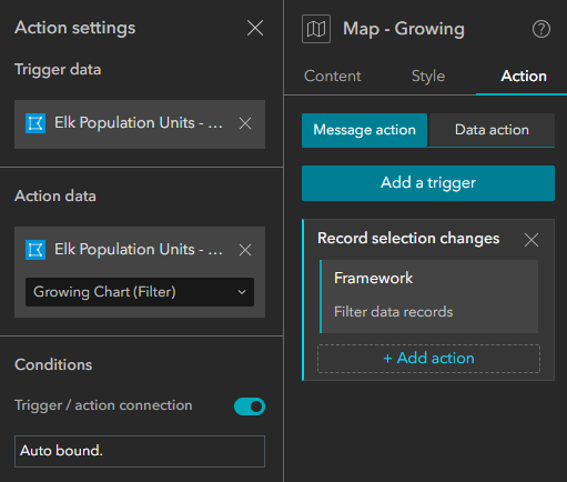

Configuration 3
Map Action - none
Feature Info - Action same as Configuration 2
Expected Behaviour:
When record selection in Feature Info changes, either scrolling through Feature Info widget or clicking on map, Chart will be filtered
Actual Behaviour:
Chart is filtered when scrolling through Feature Info widget, but defaults to no filter (ie. all features) when selecting record in map

ShengdiZhang
Hi, you set the action on the map widget, but I would recommend setting the action on the framework.
It's generally better to set actions on the Framework level rather than the widget level. Targeting the action on the map widget will only filter the data displayed in that specific map view. However, by setting the action on the Framework, any other widgets that are using the same data source will also get filtered.
TaraHaynes
This is my configuration 2 as shown above, where I tried setting the action on the Framework. I did the same in configuration 3. The action on the map is just for zooming to the map, I have not set any actions that filter the map:
Edit to add: this is the configuration that is giving me an INVALID CHART output. My issue is that I would like both the map and the feature info widget to be able to filter the chart, but the map filtering seems to conflict with the feature info filtering.
