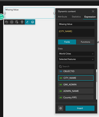

Hello,
I was wondering if anyone maybe knows how to format a dynamic text value (attribute) with a default value if empty. I would prefer to do it via UI, not in the DB.
Something like:
If missing then "Missing value"
else {Attribute}
I couldn't find any info on this.
DanJiang
Hi @DavidRasner1 ,
You can use the Expression instead of the Attribute in Dynamic content. Set the expression name as the default value you want and configure the expression content as the attribute.
6 Replies
DanJiang
Hi @DavidRasner1 ,

apgis16
I tried to do this with a date field I have within a list. I want it to display "Pending" If it's NULL. The populated dates show up but the empty ones still don't show anything. Does this not work on a date field?
LindsayWithers1
I'm having the same problem, but on a numeric field. Did you ever get the Expression name to work for null values on your date field?
apgis16
No 😞
