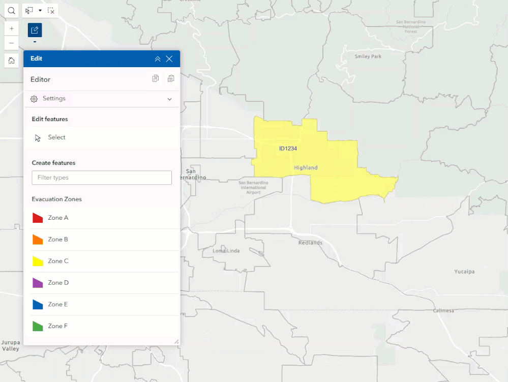

Copy and Paste in now available in Experience Builder in ArcGIS Online. You can find it in the Edit widget, when using "Interact with a Map widget" Mode. The option is at the bottom of the Content panel, as part of the Advanced editing tools.

@SDIGITAFB Copying features from non-editable reference layers in the map is supported.
Here's a sample you can try out: Create Evacuation Zones
The web map contains the USA ZIP Code Boundaries (a non-editable reference feature layer), along with the Evacuations editable hosted feature layer that you can paste into.
Since the reference layer is not editable, you'll need to use other selection tools than the one included with the Edit widget to select the features to copy. For example, you can use the Select tool in the Map widget.
You can also use the Add Data widget to add layers to the map use copy features from those layers to paste into your editable layers.
