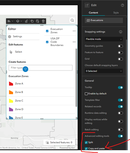

AlixVezina
Copy and Paste in now available in Experience Builder in ArcGIS Online. You can find it in the Edit widget, when using "Interact with a Map widget" Mode. The option is at the bottom of the Content panel, as part of the Advanced editing tools.
