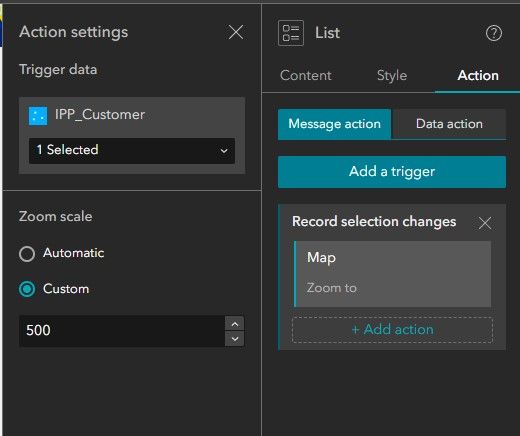

I am working on an Experience that uses a list widget to show property points on the map, and you can select one of those places and the map will zoom to that location. I have it configured so you can click on a More Info button that takes you to the feature info, or you can simply unselect it if you only wanted to zoom into the location. I currently have this as a message action when the record selection changes in the list.
I've been trying but haven't had much luck in figuring out that if someone were to unselect the location from the list, can the map then automatically zoom out to it's default extent? This would greatly improve the functionality of my app as I'm basically recreating a Short List Story map into experience builder.
