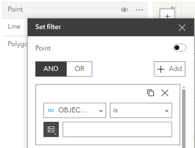

SumitZarkarCT
@aawadrsk
With the latest Feburary2024 release you can now set filters at runtime using the Map Layers widget
https://doc.arcgis.com/en/experience-builder/latest/get-started/whats-new.htm
SumitZarkarCT_1-1711622590948.pngSumitZarkarCT_1-1711622590948.pngSumitZarkarCT_2-1711622630969.pngSumitZarkarCT_2-1711622630969.png
Hope this could help.

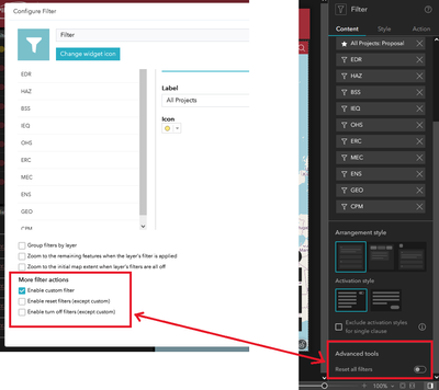

Ke_Xu
by Esri Regular Contributor
Hi all,
Custom filters can now be set at run time with the Filter widget on November 2024 ArcGIS Online.
Please follow the steps below:
1. Add a Filter widget, click the New custom filter button to create a custom filter.
2. Select the data that you want users to use to make custom filters at run time. You can select multiple data sources.
3. Turn on Live view or Preview.
4. You could create the clause or clause set at run time.
Thanks,
Ke

Ke_Xu
Hi @HannahWilson3,
This new feature will be released in the upcoming ArcGIS Enterprise 11.5(at the end of May) . You could also use ArcGIS Experience Builder Developer Edition 1.16 with your current Enterprise.
Thanks,
Ke
