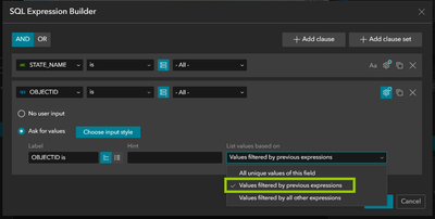

Is there a way to filter a list within a filter based on the selection from another filter? This was easily done in dashboards but can not find a way within the ExB applicaton.

Hi @Kyle_Kaskie,
"Values filtered by previous expressions" could be used.
Please feel free to contact me if you have any questions.

Hi @Ke_Xu,
Does this work with group filtering as well?

Hi @Kyle_Kaskie,
The group filters doesn't have this option.
For Group SQL Expr Builder, the unique values are not affected by other clauses - since it is counted as one clause for each Group SQL Expr Builder. The related question is as below:
