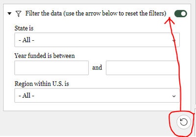

I'm using Experience Builder in Enterprise Portal 11.2. In the Filter widget I've enabled the "Reset all filters" option, but the reset button/arrow isn't in the most intuitive place (see screenshot below). Is that the only location the reset button can be or (without using the dev version of Experience Builder) is there a way to move the button? It would be nice if it was at least within the white area/panel of the Filter widget.
TonghuiMing
@LindsayWithers1 Thanks for brining this up, we will take a look and evaluate that.
Also be aware that, in your case, there is only one filter item with the regular vertical style with the toggle button; there are other cases where there might be multiple items (hence multiple toggle buttons), and also only button style as the filter items. We are trying to provide a solution compatible with all those cases.
