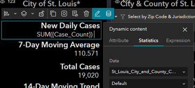

Hi John, I just tried it again and it worked for me.  I may not understand your setup.  There are many configuration steps.  In my case, I set up several views in the Data portion of the Experience Builder using the same data.   I then have 3 Cards in a single row.  In each Card, I added different text elements.   Each text element connects to the data and a specific view through dynamic content.   I then set a filter in Card 3 for all the text elements in Card 3 using the same view.  If I use a different view of the data in Card 2, the data doesn't change with the filter.
I hope the following clarifies what I did.

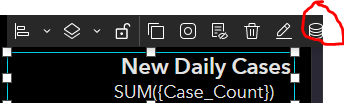

Here's where I add data and set the view (4th icon down)
Here's where I'm configuring a text element in the card selecting the data and the selecting a view.  In each case, I would only select one view.
Then in the text element, I would use the red circled dynamic content button to select the data and view and the variable
And configuring the content.  If I change the data source of view, I find it best to delete the old value and add a new one.

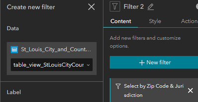

And here is the configuration I used for the filter selecting the same data and specifying a view.

Here's a screenshot of two filters using two different views of the same data.  In my case, the filters are acting only on the same views used in dynamic text.   The value below the filter is the filter result.
