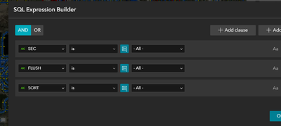

I am using OR in my case, but I have a few applied and it works as expected.
I then have other filters set up on that same layer with different fields.
I went to another application to look for 'AND'
I have 3 here that seem to be working.
Is this what yours looks like or am I off??
