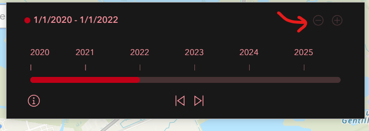

It seems the latest iteration of the timeline widget has the zoom feature disabled and it will not work. There are no settings in the widget setup that I can find. This was working fine before the latest update, but now the + and - buttons are greyed out and not responding.

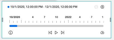

@JeffreyROLAND Whether the zoom feature displays depends on your web map or layer's setting for the minimum time accuracy, as well as the time step setting. See my example of min time accuracy = 1mon, step = 2mon, full extent=2 years, the zoom buttons display as expected:
This needs to be adjusted by your time-related settings. I am unable to reproduce it on AGOL.
However, if you did not change the app settings or web map/layer settings, and the app upgrades with this change, it would be helpful to provide the sample app for us to take a look.
