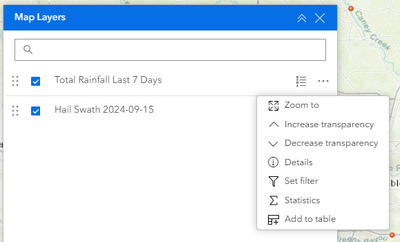

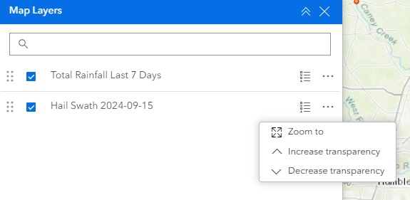

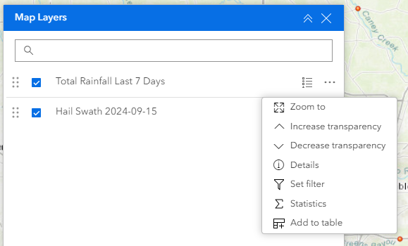

It adds to layer list:
but with limited functionality compared to other layers added through Add Data widget:

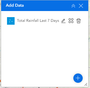

It also does not show up in the Add Data widget:
