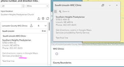

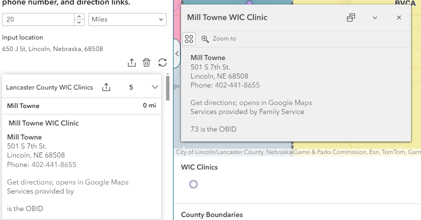

I'm working in ArcGIS Online, Experience Builder, Near Me widget.

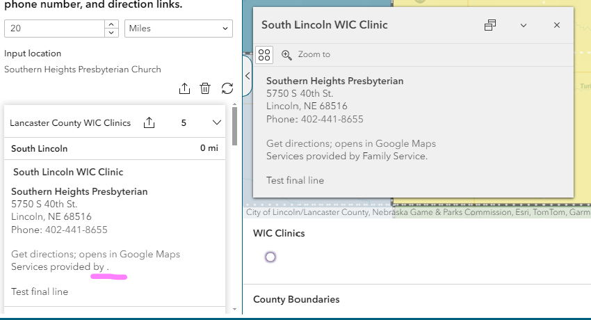

The issue is the results list in the Near Me widget is not showing all the information contained in the webmap popup.
Here's the original test screen. In the search results after "Services provided by " it should read "Family Service" Pop up for the same location shown for reference.

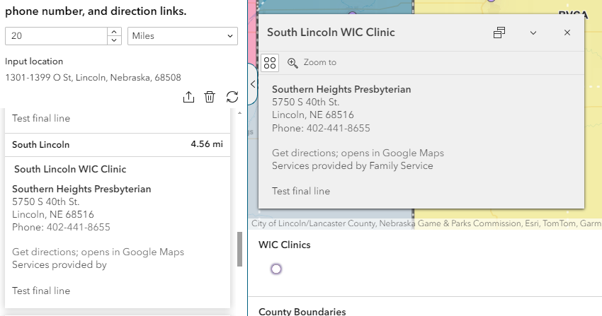

I thought maybe there was a number of lines or text issue, so I added a new blank and text line, but those new lines show.
I thought having punctuation after the {} would matter, it didn't.

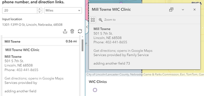

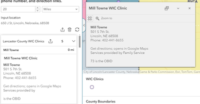

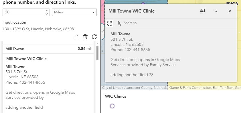

I tried adding another reference field two different ways and neither of those worked either

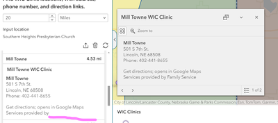

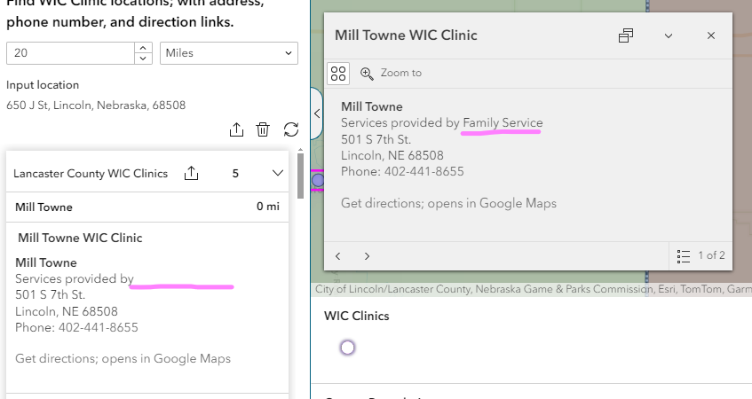

I tried moving the Services Provided line up the the pop up and that didn't work either.

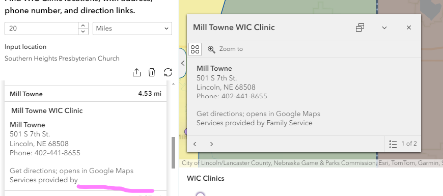

At this point I'm out of ideas. Occasionally the popup will be missing the information behind "Services Provided," as well

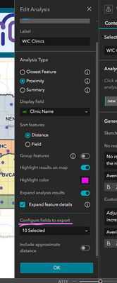

I finally found what was causing the referenced field to not show.
In the Near Me Edit Analysis window there is a place where you can configure the export fields. All fields that you want to show in the Near Me results must be turned on in the "Configure fields to export" box.
I tested this with two other fields (building name and ZIP code); both disappeared from the Near Me results when turned off in the export box.
That's confirmation enough for me - I hope this can save someone else some frustration.
